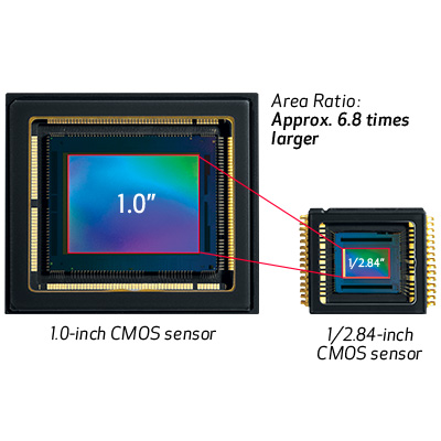

The VIXIA GX10 camcorder features a Canon 1.0-inch 4K UHD CMOS image sensor capable of 4K UHD video capture at 60p and slow motion recording up to 120fps in Full HD, making the VIXIA GX10 camcorder a strong contender for professional productions, creative fields and more.
The VIXIA GX10 camcorder's 1.0-inch sensor allows for larger photosites compared to smaller-sized sensors, resulting in improved images with less noise in low-light situations. The larger sensor also exhibits a shallower depth of field at large apertures, providing greater depth of field control and creative options. The camcorder's new DIGIC DV 6 imaging engine further enhances the high sensitivity and low noise performance of the camcorder.

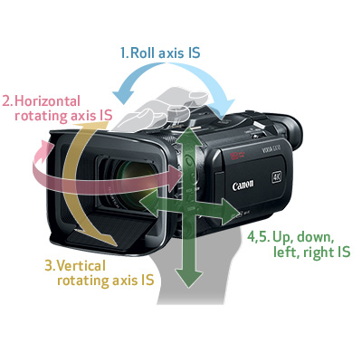

The VIXIA GX10 camcorder also incorporates a 5-axis Optical Image Stabilization (IS) system.
The camcorder features three modes of image stabilization: Standard, Dynamic and Powered. In Standard IS mode, the stabilizing angle is made constant independent of the zoom magnification. Dynamic IS mode extends the stabilizing range at the wide end of the focal length, allowing for image stabilization when shooting while walking. Powered IS mode helps facilitate stabilization in the low frequency range at the tele end, and should be used exclusively for fixed-point shooting which does not involve panning.

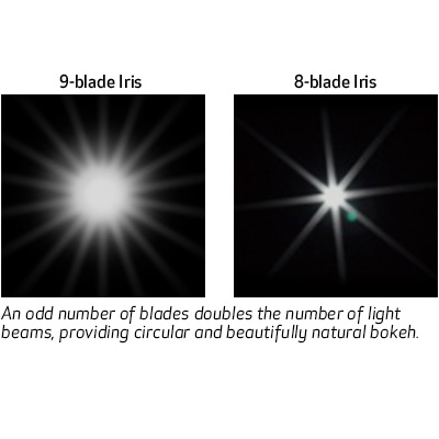

9-blade Iris
For enhanced versatility and durability, the lens features a 9-blade iris, producing artistic and beautiful out-of-focus areas or "bokeh." The 9 blades allow for attractive circular blurring in out-of-focus regions, while the use of an odd number of blades helps reduce flaring of specular highlights.

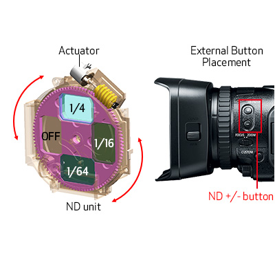

A compact and independent internal 3-density ND filter, using a turret (circular) mechanism, allows the user to select from three densities (ND 1/4, ND 1/16 and ND 1/64) or turn the feature off if needed. Density can be adjusted using the dedicated external buttons.

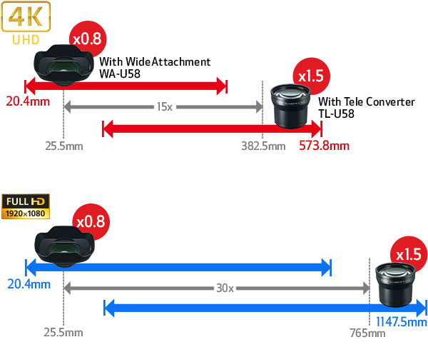

The optional Wide Attachment WA-U58 and the Tele Converter TL-U58 accessories expand the creative capabilities of the VIXIA GX10 camcorder.
The Wide Attachment WA-U58 offers a 0.8x wider angle of view that enables users to capture more of a scene, especially when indoors or in tight spaces, to lend better perspective to your video narrative. The Tele Converter TL-U58 provides extended 1.5x longer telephoto range for the VIXIA GX10 camcorder's fixed lens, allowing distant subjects to be captured with brilliant clarity.

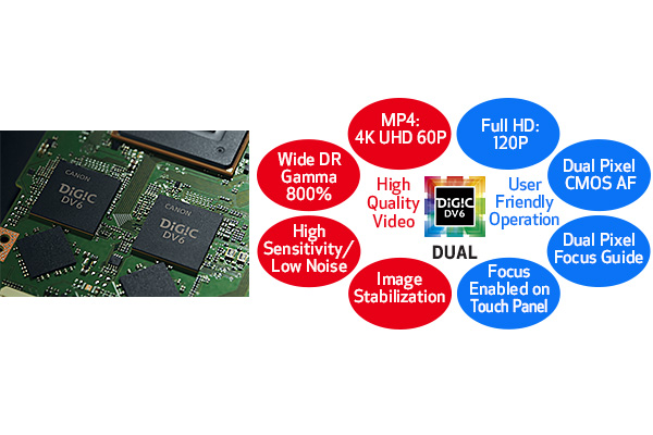

The VIXIA GX10 camcorder incorporates Canon's dual DIGIC DV 6 Image Processors, which are integral in providing high image quality, advanced performance and convenient operability. This advanced core technology component provides the image-processing power and speed that enables features such as 4K UHD video acquisition, image stabilization, slow and fast motion recording and precise Dual Pixel CMOS AF.

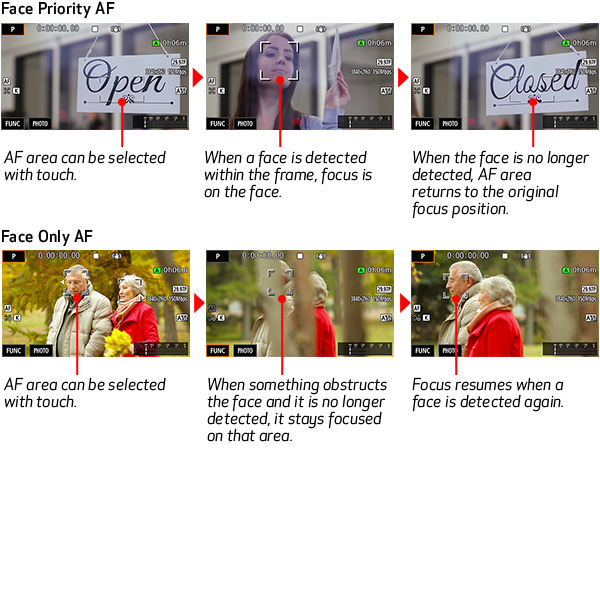

The VIXIA GX10 camcorder's 3.5-inch touch panel LCD enables smooth, intuitive operation of Dual Pixel CMOS AF. Accurate AF technology can be employed when shooting a scene by tapping a finger on the desired area of the scene you want the lens to focus on. Dual Pixel CMOS AF offers continuous AF within a horizontal and vertical range of the screen of approximately 80%. It also provides highly accurate Face Detection AF, which assists during single-operator shooting. Users can also use the touch panel to move the autofocus target manually.
The Face Detection AF feature has two modes Face Priority AF and Face Only AF that offer users precise flexibility in how they choose their autofocus for a subject or scene.

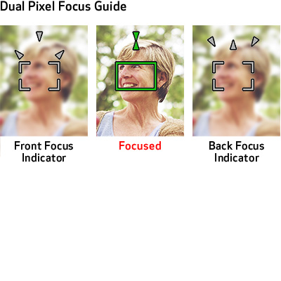

Utilizing information from Dual Pixel CMOS AF, Dual Pixel Focus Guide helps achieve precise focus by displaying focus assist information on the screen. It employs a truly innovative user interface that enables the user to see if they are focused in front of or behind the subject through visual observation, and allows quick and accurate manual focus to be achieved. This helps simplify the focusing process when shooting in 4K UHD, which requires strict focus accuracy.

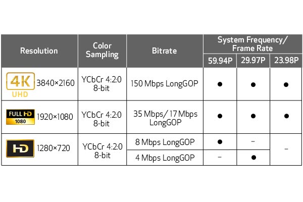

The VIXIA GX10 camcorder offers 4K UHD (3840 x 2160) and Full HD (1920 x 1080) recording in MP4 format at up to 60p. The compact size of the MP4 codec allows the VIXIA GX10 to capture images directly to low-cost SD cards. Support for 4K UHD at 60p allows the VIXIA GX10 to be used in a wide variety of shooting situations.

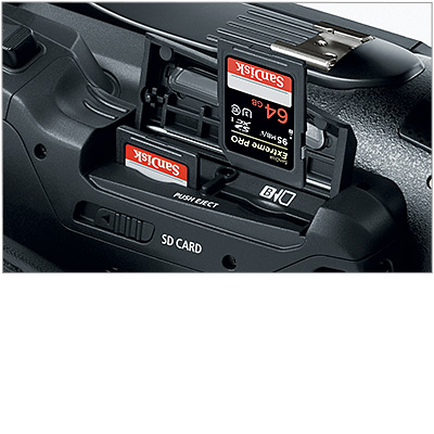

Simultaneous or relay recording in MP4 format to the VIXIA GX10 camcorder's dual SD card slots is possible.
Simultaneous recording allows you to record on both SD cards at the same time, so that you can use one as a backup.
Relay recording allows uninterrupted recording from one card to the other when the first memory card becomes full.

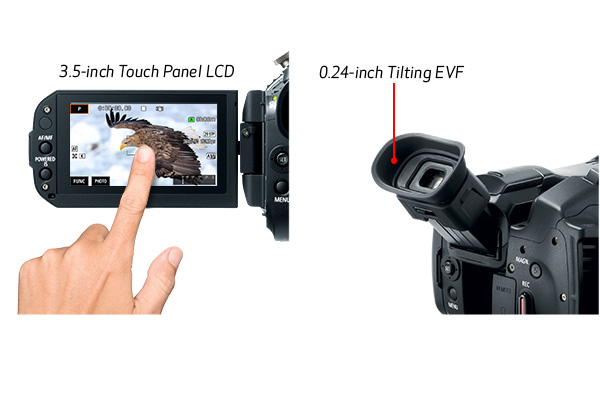

The VIXIA GX10 camcorder features a 3.5-inch Touch Panel LCD and a newly designed 0.24-inch Electronic Viewfinder (EVF). The Touch Panel LCD and EVF both display approximately 1.56 million dots and provide visual recognition of desired features along with a full array of menu options for controlling camcorder settings. The Touch Panel LCD works with Canon's exclusive AF technologies for easy monitoring and one-finger tap-focusing during shooting and the EVF offers 60° of tilt for more comfortable operation in a variety of positions.

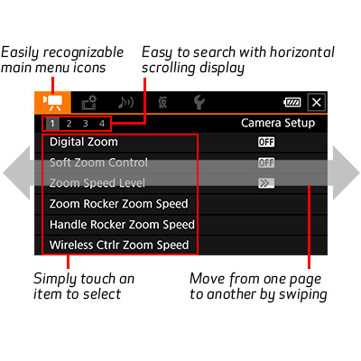

The VIXIA GX10 camcorder features an intuitive menu design for fast and accurate access to desired features. Interactive direct touching and moving from one page to another are also possible by swiping the menu screen.

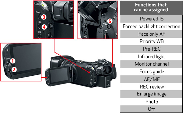

The VIXIA GX10 camcorder features 5 assignable buttons, in addition to touch-assignable buttons on the upper part of the LCD panel. Users can set them to the features they need.

| Video Recording System | Compression: MPEG-4 AVC/H.264 Color Sampling: 4:2:2 Or 4:2:0 File Format: MP4 Recording Modes: 150 Mbps: 3840x2160 (60p/30p/24p) 35 Mbps: 1920x1080 (60p/30p/24p) 17 Mbps: 1920x1080 (60p/30p/24p) 8 Mbps: 1280x720 (60p) 4 Mbps: 1280x720 (30p) |

| Viewfinder | 0.24-Inch TFT Wide Color LCD, Approx. 1.56 Million Dots, Approx. 100% Field Of View |
| Lcd Screen | 3.5-Inch Wide LCD And Wide View Angle, Wide Color Range Supported And AR Surface Treatment (Approx. 1.56 Million Dots) |

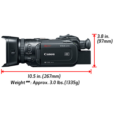

| Dimensions | Approx. 5.3 X 3.8 X 8.4 In. / 135 X 97 X 214mm (Excluding Lens Hood And Battery Pack) Approx. 5.9 X 3.8 X 10.5 In. / 150 X 97 X 267mm (Including Lens Hood And Battery Pack BP-828) All Dimensions Exclude The Grip Belt. |
| Weight | Approx. 2.5 Lbs. / 1140g (Body Only) Approx. 3.0 Lbs. / 1335g (Includes Lens Hood, Battery Pack BP-828 And 1 Memory Card) Grip Belt Included For All Values. |
