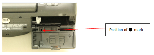

NOTE: If the battery cover contains the marking illustrated below, the camera is NOT affected by the phenomenon described above even if the first and second digits of the serial number are of the numbers mentioned above.
