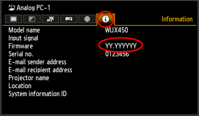

Firmware version confirmation method:
You can confirm the firmware version by following the steps below.
  1. Project a blank screen.
  2. Press the MENU button on the Side Control (or on the remote control) of the projector to display the menu screen.
  3. Use the right pointer button to go to the [Information] tab.
  4. Check the firmware version.
