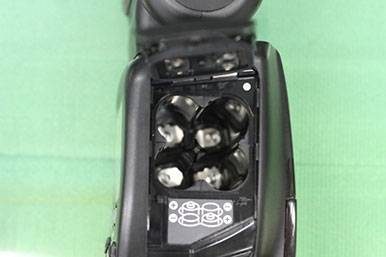

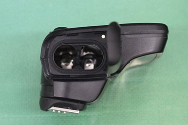

Units with a combination of 3rd and 4th digits in the serial number in the ranges shown below are affected.
  • Speedlite 600EX-RT: [xx01xxxxxx] ~ [xx13xxxxxx]
  • Speedlite Transmitter ST-E3-RT: [xx01xxxxxx] ~ [xx03xxxxxx]
However, even if the serial number is within the ranges above, the unit is NOT affected if there is a round, white dot at the top right of the battery compartment as shown in the photos below.
speedlite_600ex-rt speedlite transmitter
Speedlite 600EX-RT
