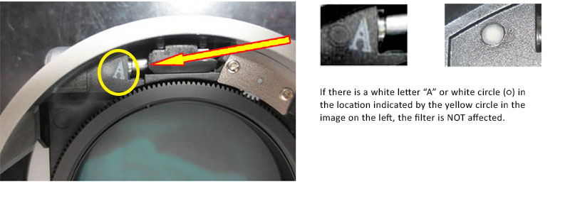

1. If the filter has one of the marks shown in the image below, it is NOT affected. It is a normal unit.
2. If the filter does not have one of the marks described in 1. above, the method below can be used to check whether or not it is affected.

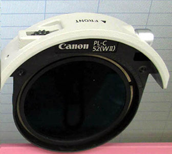

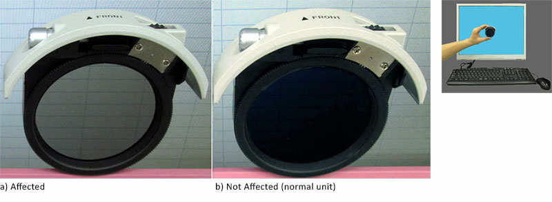

With the [▲FRONT] marking on the filter facing forward (towards the computer monitor's screen), when the dial is rotated, the filter surface of non-affected filters will turn dark (black) as shown in image b) below.
Affected units will change color as shown in image a) below, but they will not turn dark (black) in the same way as non-affected units.
When one of the affected units shown in image a) above is held in the opposite orientation and then rotated, it will turn dark (black).
