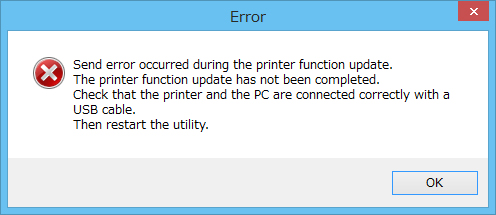

NOTE: If the error message below appears when attempting to run the firmware update, the printer does not need the Firmware Update Version 1.051. Please click OK to close the window. Please use the identification procedure listed above to identify affected models.
PIXMA MG3510 error message.
