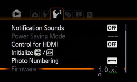

| How to identify units that are covered by this firmware update Firmware versions covered by this update If the firmware for your camcorder is currently version 1.0.0.0 through 1.0.4.0, please perform this update. If the firmware version is already 1.0.5.0, this update does not apply. You can check the firmware version of your camcorder by following the procedure below. | |
| 1. Set the camcorder to photo playback mode. | |
| 2. Press the FUNC. (function) button, and then select Menu. | |
| 3. Operate the joystick to select the System Settings tab. | |
| 4. Check the version shown in Firmware. (1.0.x.0) | |
