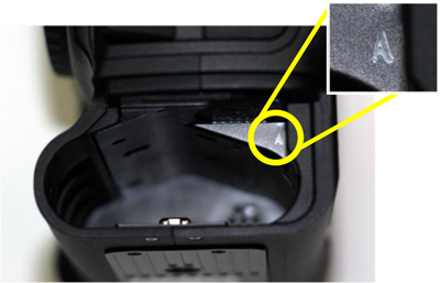

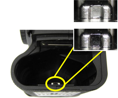

    NOTE: If the camera’s battery compartment contains one of the markings illustrated below, the camera is NOT affected by the phenomena described above even if the first and sixth digits of the serial number are of the patterns mentioned above.
Markings of UNAFFECTED cameras
An “A” mark
A black mark on the silver bracket
