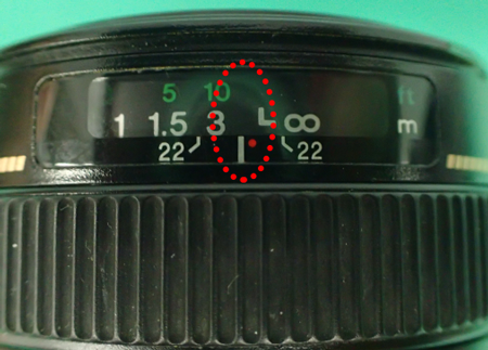

While in AF or MF mode, when the focus position is moved from the infinity end to the close-up end, the focus operation stops near the area shown in the dotted circle below.
