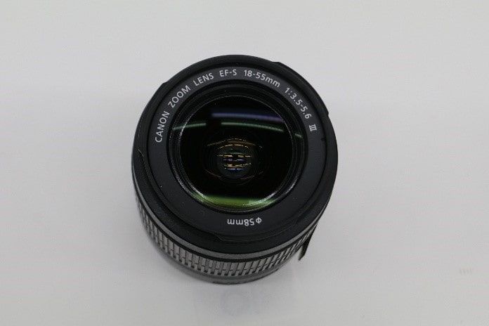

![]() 「EF-S18-55mm F3.5-5.6 III」

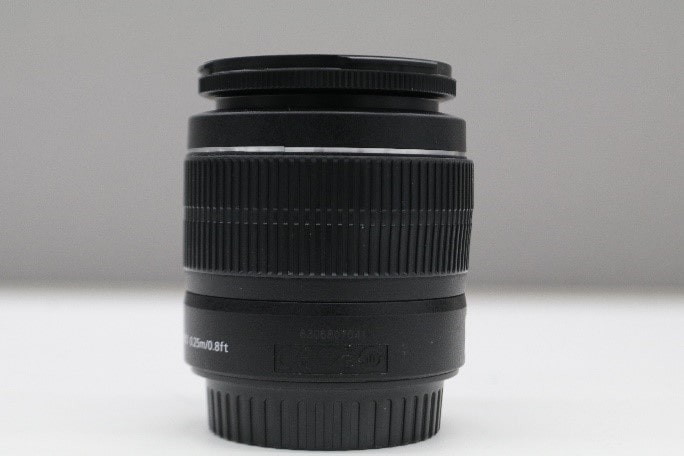

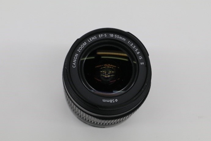

![]() Certain units that exhibit the following numbers in the first four digits of the 10-digit serial number listed on the lens are affected. (See images below) Serial Numbers Of Affected Units 「EF-S18-55mm F3.5-5.6 IS II」
“2969******”、“3069******” ![]() 「EF-S18-55mm F3.5-5.6 III」
“2969******” ![]() The issue occurs on some units that were manufactured within the period listed above. To verify whether your lens is affected, please read through the details under “How to check if your lens is affected”. How to check if your lens is affected: (1) Click here to display the serial number input screen. (2) Input your lens’ serial number (10 digits) and then click the [Submit] button. (3) One of the following three messages will be displayed. “Your lens is not an affected product.” “Your lens is an affected product.” “Invalid number” * The list of affected units will be updated on a regular basis as needed. Support Please note that if your unit is within the scope of affected units as described above, but is experiencing an issue other than the one described herein, a fee to repair your unit may apply. Please make sure that the lens cap and dust cap are attached to your lens when sending it in for repair, and kindly note that we will only accept your lens alone (not the camera). Period of Accepting Free Repairs Until 10/31, 2026 Contact Information Should you have any questions about the announcement, please contact the Authorized Service Facility in your area or you may contact the Call Center within your region. |
