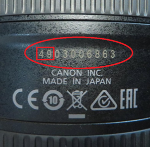

If the first two digits in the serial number (see the image below) of your lens are ”48”, ”49”, ”50” or ”51”, then your lens MAY POSSIBLY be affected.
Lens Serial Number
