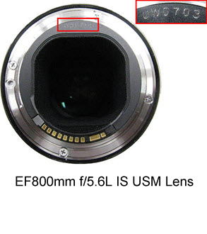

*If the fifth and sixth digit of the six-digit alphanumeric number that is imprinted on the mount of the Lenses is of any of the following numbers, the Lens is affected.
EF200mm f/2L IS USM: If the fifth and sixth digit is 00, 01, or 02.
EF800mm f/5.6L IS USM: If the fifth and sixth digit is 00, 01, 02, 03, 04, 05, or 06.
How to Identify Affected Products:
Please check the six-digit alphanumeric number as indicated in the image below.
