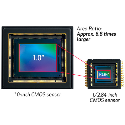

The XF405 Professional Camcorder features a Canon 1.0-inch 4K UHD CMOS image sensor capable of 4K UHD video capture at 60p and slow motion recording up to 120fps in Full HD, making the XF405 camcorder a strong contender for professional productions, creative fields and more.
The XF405 camcorder's 1.0-inch sensor allows for larger photosites compared to smaller-sized sensors, resulting in improved images with less noise in low-light situations. The larger sensor also exhibits a shallower depth of field at large apertures, providing greater depth of field control and creative options. The camcorder's new DIGIC DV 6 imaging engine further enhances the high sensitivity and low noise performance of the camcorder.

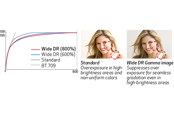

Wide DR Gamma (800%) Support
For natural and realistic-looking image capture that faithfully represents the scene at hand, Wide DR Gamma achieves a wide dynamic range of 800% to produce almost seamless tone gradations, resulting in smooth detail, accurate color and virtually no blown-out highlights.

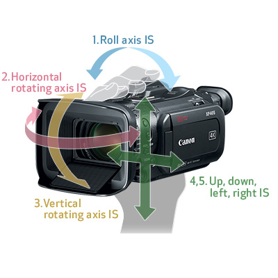

The XF405 camcorder also incorporates a 5-axis Optical Image Stabilization (IS) system.
The camcorder features three modes of image stabilization: Standard, Dynamic and Powered. In Standard IS mode, the stabilizing angle is made constant independent of the zoom magnification. Dynamic IS mode extends the stabilizing range at the wide end of the focal length, allowing for image stabilization when shooting while walking. Powered IS mode helps facilitate stabilization in the low frequency range at the tele end, and should be used exclusively for fixed-point shooting which does not involve panning.

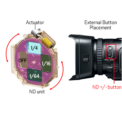

A compact and independent internal 3-density ND filter, using a turret (circular) mechanism, allows the user to select from three densities (ND 1/4, ND 1/16 and ND 1/64) or turn the feature off if needed. Density can be adjusted using the dedicated external buttons.

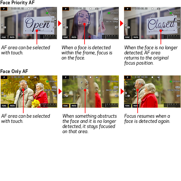

The Face Detection AF feature has two modes - Face Priority AF and Face Only AF - that offer users precise flexibility in how they choose their autofocus for a subject or scene.

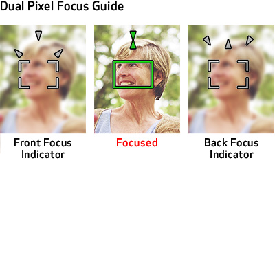

Utilizing information from Dual Pixel CMOS AF, Dual Pixel Focus Guide helps achieve precise focus by displaying focus assist information on the screen. It employs a truly innovative user interface that enables the user to see if they are focused in front of or behind the subject through visual observation, and allows quick and accurate manual focus to be achieved. This helps simplify the focusing process when shooting in 4K UHD, which requires strict focus accuracy.

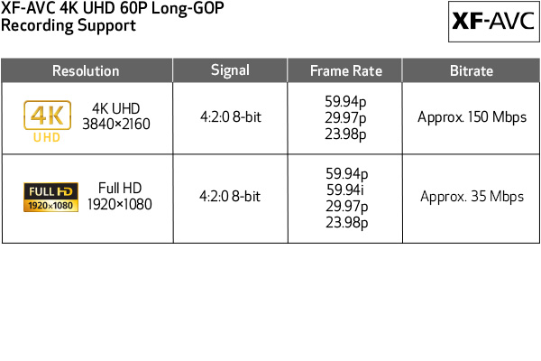

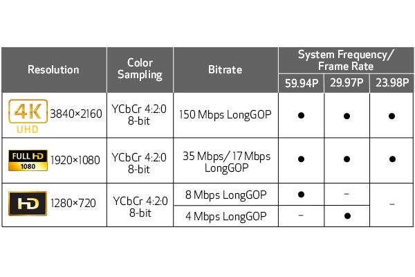

The XF405 Professional Camcorder offers 4K UHD (3840 x 2160) and Full HD (1920 x 1080) recording in MP4 format at up to 60p. The compact size of the MP4 codec allows the XF405 to capture images directly to low-cost SD cards. Support for 4K UHD at 60p allows the XF405 to be used in a wide range of fields from broadcasting to cinema.

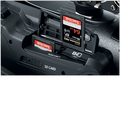

Simultaneous or relay recording in MP4 format to the XF405 camcorder's dual SD card slots is possible.
Simultaneous recording allows you to record on both SD cards at the same time, so that you can use one as a backup.
Relay recording allows uninterrupted recording from one card to the other when the first memory card becomes full.

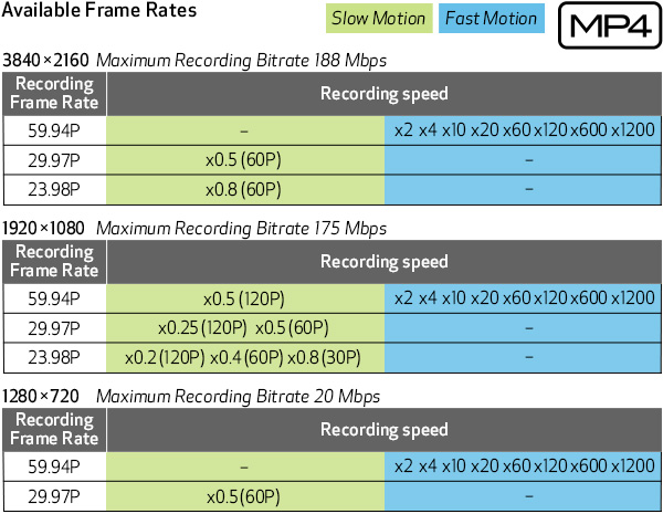

The XF405 Professional Camcorder supports slow and fast motion recording, and can record in a different frame rate from playback for slow and fast motion effects. Slow motion recording of up to 120 fps (x0.2) in Full HD is supported, helping to create an emotionally moving and exciting style of video.

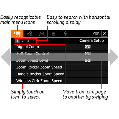

The XF405 camcorder features an intuitive menu design for fast and accurate access to desired features. Interactive direct touching and moving from one page to another are also possible by swiping the menu screen.

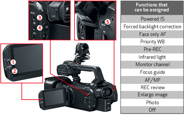

The XF405 camcorder features 5 assignable buttons, in addition to touch-assignable buttons on the upper part of the LCD panel. Users can set them to the features they need.

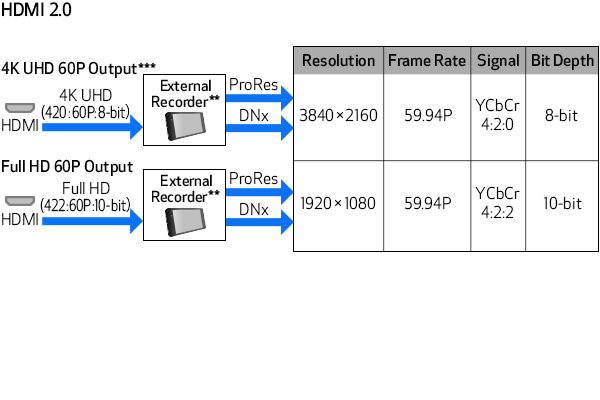

The XF405 Professional Camcorder features an HDMI 2.0 terminal that supports 4K UHD 60p output. The HDMI 2.0 terminal allows the camcorder to be connected to a standard external SSD/HDD recorder, enabling conversion to ProRes and DNx formats for efficient editing and storage.
** Internal recording not enabled.
*** Restrictions apply only when shooting in 4K UHD 60P. OSD overlay disabled / Browser remote Live View disabled.

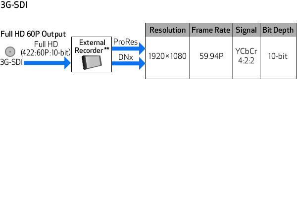

The XF405 Professional Camcorder features a 3G-SDI output terminal that supports camcorder integration into professional workflows, making it particularly useful for on-the-go Electronic News Gathering (ENG) applications.

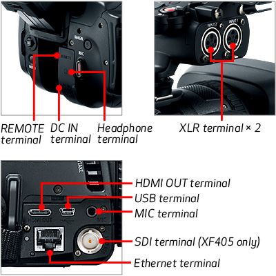

The XF405 Professional Camcorder offers a variety of ways to record audio: through two XLR terminals, an internal stereo mini-jack mic terminal or from the camcorder's internal stereo mic. In addition to AAC 2ch audio, the XF405 offers support for high-quality linear PCM 4ch audio. The on-board 4ch audio independent settings let users set recording levels, input sensitivity and limiters for each channel.
Two professional XLR microphone connectors are provided on the handle unit of the XF405 camcorder. They can be controlled independently to help ensure the proper audio levels are being captured correctly.

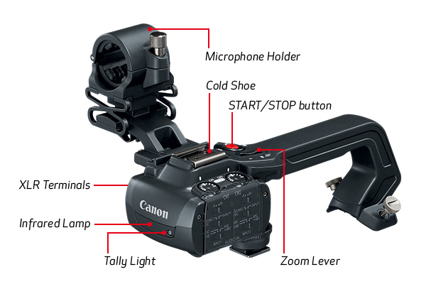

The XF405 Professional Camcorder is compact and lightweight, making it especially useful for on-the-go Electronic News Gathering (ENG) and documentary production applications.
The detachable handle unit can be quickly and easily attached to the camcorder body without tools. The handle includes a zoom lever, a start/stop record button and two XLR terminals to support professional audio. The handle is also capable of mounting a mic holder and features a cold shoe that can be used to mount a variety of other optional peripherals.
