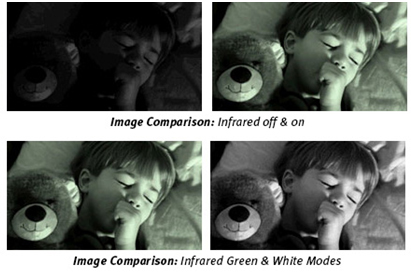

The Canon XF200 is a compact, high-performance Professional Camcorder designed to fulfill a broad spectrum of shooting requirements for users working on sports production, ENG, documentaries, commercials and corporate shoots, as well as for independent movie productions, government applications, film schools, colleges, weddings and other event videography. The camcorder features a wide-angle 20x optical zoom lens with three control rings, full image stabilization, infrared capabilities, flexible MXF/MP4 dual recording at various data rates, two/four-channel audio recording, a network interface and dual-band Wi-Fi®.

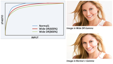

A versatile Canon 20x HD wide-angle video lens captures images with outstanding clarity across a broad 26.8–576mm* zoom range. A wide dynamic range gamma setting prevents overexposure even for bright areas of an image and/or with non-uniform colors. An eight-blade circular aperture provides natural and visually pleasing bokeh. Three separate lens rings offer independent control of focus, zoom and iris/aperture settings. A new Five-Axis Dynamic SuperRange OIS System further reduces the effects of camera shake, and a new rotating handgrip enables comfortable camera positioning at all shooting angles from high to low.

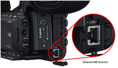

Dual-frequency Wi-Fi® and a CAT-5 Ethernet connector enable browser preview during shoots, in addition to FTP transfer to external PCs or laptops. The XF200 can also be used with Canon’s new RC-V100 Remote Controller to provide full access to all important user functions, including start/stop, shutter/gain, zoom/focus/iris, white balance, black gamma and more.

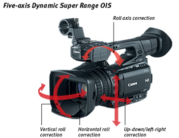

The XF200 professional camcorder's new Five-Axis Dynamic Super Range OIS system combines optical and electronic correction to help reduce image distortion- even when shooting while walking - for better looking videos. Standard Mode uses lens shift to provide constant compensation throughout the zoom range. Powered Mode helps improve vibration suppression at telephoto focal lengths. Dynamic Mode is specifically designed to stabilize the image when walking and shooting handheld by correcting simultaneously for roll, yaw and pitch.

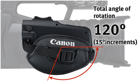

The XF200 professional camcorder features an aluminum die-cast grip that can be rotated through a wide 120-degree angle in discrete 15-degree steps. Cinematographers and other operators can maintain a firm and comfortable hold of the camera at any shooting angle.

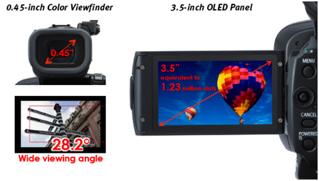

The 3.5-inch, touch-sensitive 1.23-megapixel Organic Electroluminescence (OLED) panel offers a number of user advantages over conventional backlit LCD-type displays, including a high contrast ratio, a wide viewing angle, high-speed response, slim dimensions and light weight.

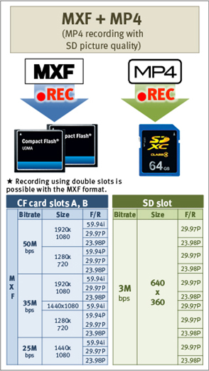

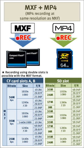

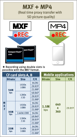

Types and specifications of dual recording:

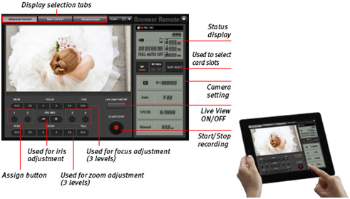

It is also possible for the camcorder to connect to compatible networks, wireless hotspots and iOS® mobile devices using the free Canon Movie Uploader app*, or play back video on the camcorders' memory cards to Wi-Fi-enabled TVs and computers. Additionally, Wi-Fi technology allows remote control of key camcorder controls, exposure functions and focus settings, conveniently from your web browser when using a smartphone or tablet.

The XF200's function lets you pass video files via FTP; this Real-Time Proxy Transfer mode enables remote control of key camera functions and transfer of proxy files. Using Canon's CameraAccess application, live video images can be viewed and/or recorded as MP4 proxy data and other operations controlled from a compatible smartphone or tablet device allowing news footage, for example, to be distributed and backed up. MP4 proxy files recorded on the compatible smartphone or tablet can be used to check material being captured at the remote location, and for news-flash footage. Live or recorded images can also be output via the camcorder's HD-SDI connectors.

| Video Recording System | Compression: 8 Bit MPEG-2 Long GOP Color Space: 4:2:2 File Format: MXF And MP4 Recording Modes: 50Mbps MXF (CBR) 4:2:2: 1920x1080 (60i/30p/24p), 1280x720 (60p/30p/24p) 35Mbps MXF (VBR) 4:2:0: 1920x1080 (60i/30p/24p), 1440x1080 (60i), 1280x720 (60p/30p/24p) 25Mbps MXF (CBR) 4:2:0: 1440x1080 (60i/30p/24p) 35Mbps MP4: 1920x1080 (60p) 24Mbps MP4: 1920x1080 (30p/24p) 17Mbps MP4: 1280x720 (60p) 9Mbps MP4: 1280x720 (30p/24p) 3Mbps MP4: 640x360 (30p/24p) |

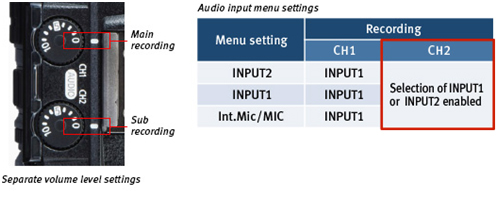

| Audio Recording System | 2/4-Channel, Linear PCM, 16-Bit, 48 KHz (MXF) |

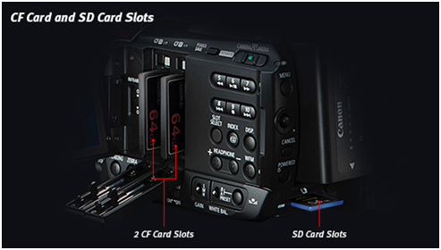

| Recording Media | CF Card (2 Slots): MXF Files SD Card (1 Slot): MP4, Still Images, Custom Picture Data, Clip Metadata, And Menu Settings |
