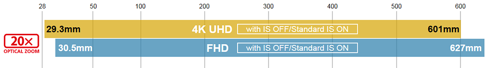

The XA45 Professional Camcorder features a Genuine Canon 20x Optical Zoom Lens that provides a highly versatile zoom range with a 35mm equivalent of 29.3-601mm to help capture newsworthy recordings near and far.

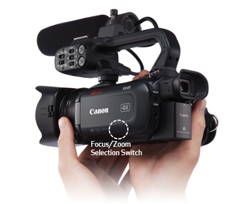

An endless-type focus and zoom control includes user-programmable direction and sensitivity modes. Zoom speed can be set to either a variable or constant (with 16 levels) speed setting, with Fast, Normal or Slow zoom speed levels.

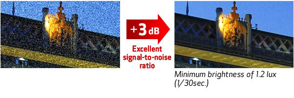

Superb Low-light Performance
Featuring a low-luminance noise rating of +3 dB, the XA45 Professional Camcorder is able to capture clear, sharp images with incredible detail even in low light.

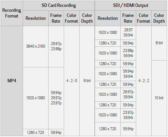

Multiple recording modes, resolutions and frame rates make the XA45 Professional Camcorder creatively flexible and adaptable to virtually any news-gathering environment. It can record to an SD card in 4K UHD and Full HD resolutions using the MP4 recording codec, at multiple bit rates- and even record simultaneously.

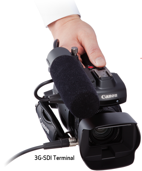

3G-SDI Terminal
A 3G-SDI terminal allows for output that supports camcorder integration into professional workflows, making it particularly useful for on-the-go Electronic News Gathering (ENG) applications. The 3G-SDI output provides an uncompressed signal at a 1920x1080 resolution with 4:2:2 color sampling and 10-bit color depth, as well as embedded audio and time code. Stream directly to a broadcast van or connecting to a recorder to make high-quality video recordings for archiving purposes.

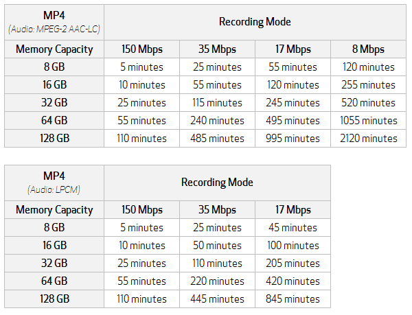

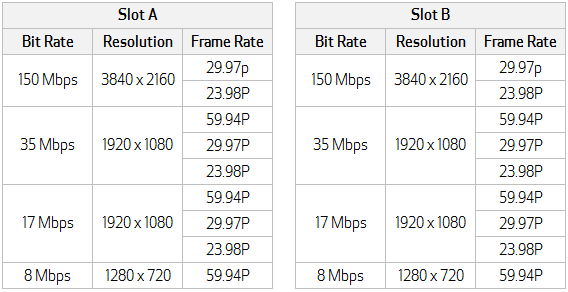

Approximate Recording Times
Dual Recording offers format choices that are useful for various post-capture options. The DiG!C DV 6 Image Processor and dual SD card slots enable simultaneous recording the web-ready MP4 format, at different bit rates.

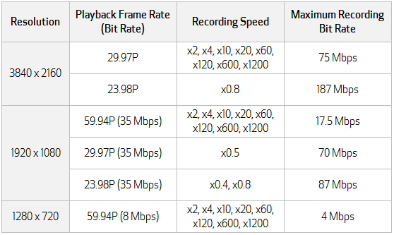

Slow and Fast Motion Modes allow the XA45 Professional Camcorder to record a different frame rate than the playback frame rate for a fast or slow motion effect during playback. Since the camera is recording real frames and modifying the playback rate, there is virtually no quality loss and maximum image quality is maintained. Additionally, interval recording allows the user to record frames at specified intervals, providing time-lapse recording of up to 1200x and slow motion down to 0.4x of the original speed.

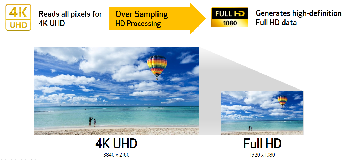

Our Full HD image quality from our XA series camcorder is now even better thanks to Over Sampling HD Processing, which enables Full HD recording by effectively utilizing the outstanding capabilities of the 4K UHD CMOS Sensor.

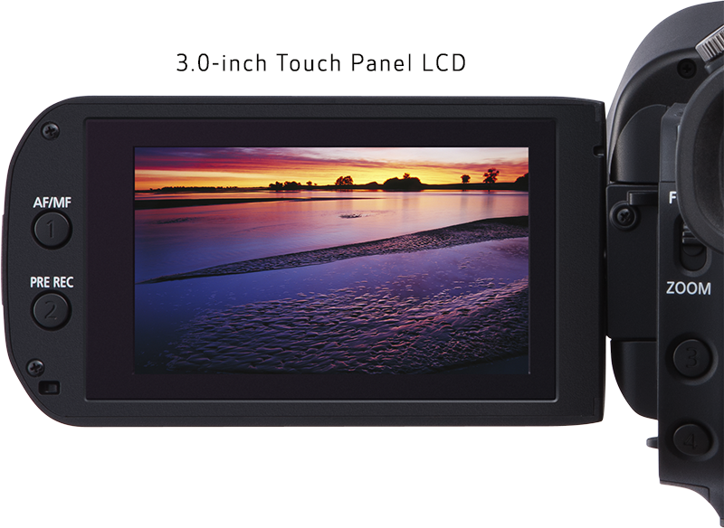

The 3.0-inch 460,000 dot LCD display provides vivid colors and high contrast. A wide-view angle (over 80° at all angles) aids in composition versatility, and regular chromaticity adjustments, which are prompted by the camcorder, help ensure correct brightness and faithful color reproduction.

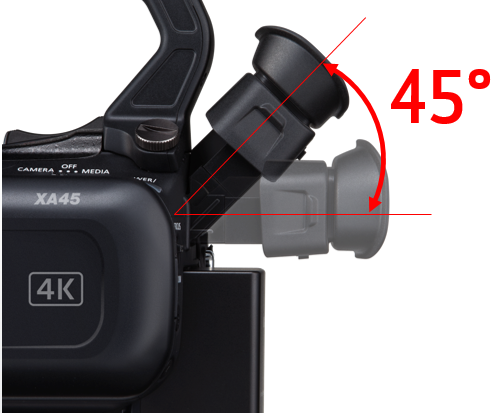

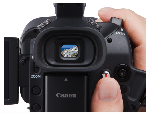

Electronic Viewfinder
The 0.24-inch tilt-type color electronic viewfinder on the XA45 Professional Camcorder has 100% field of view, and 1.56 million dots of resolution help ensure critical focus adjustment, with peaking applied if necessary. The viewfinder can tilt up to 45° for low-angle shooting. A joystick located to the right of the viewfinder, where the thumb rests, enables control of camera settings on the viewscreen without having to use touch panel controls.

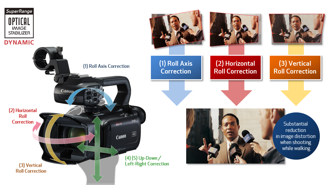

The XA45 Professional Camcorder offers a powerful optical image stabilization system suited to help reduce image blur in a wide variety of shooting situations. The different image stabilization options can be selected manually, or Intelligent IS can use an automatic detection system to identify the proper stabilization mode for the situation. Featured on the XA45 is Dynamic Mode, which provides electronic correction of roll and tilt.
Dynamic IS
Used for image stabilization at the wide end, Dynamic IS builds on translational (up-down/left-right) stabilization, adding roll axis correction, horizontal roll correction and vertical roll correction for five-axis correction. Image distortion is substantially reduced, even when shooting while in motion.
Macro IS
Macro IS corrects angular and shift-type shake in wide-angle shots.
Powered IS*
Used for image stabilization in telephoto shooting, Powered IS corrects for low-frequency camcorder shake.

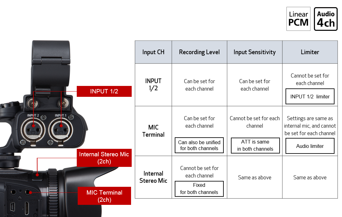

A stereo microphone is incorporated into the XA45 Professional Camcorder, and two XLR audio inputs with +48 V phantom power is on the detachable handle unit. The built-in microphone supports plug-in power, and provides outstanding audio in fast-paced situations while the XLR inputs provide connectivity to external microphones and other professional audio devices. If you choose, the built-in microphone and XLR input can be used simultaneously.
Audio is recorded in 16-bit PCM format at 48 kHz for amazing quality and fidelity. And both the built-in microphone and XLR inputs have the option for automatic or full manual gain control. To prevent variations in the recorded audio level, the dial can also be locked.
The XA45 also includes a 3.5mm headphone terminal with 16 volume settings for accurate audio monitoring.
The XA45 Professional Camcorder offers a variety of ways to record audio: through two XLR terminals, an internal stereo mini-jack mic terminal or from the camcorder's internal stereo mic. In addition to AAC 2ch audio, XA45 offers support for high-quality linear PCM 4ch audio and manual gain control. The on-board 4ch audio independent settings let users set recording levels, input sensitivity and limiters for each channel.

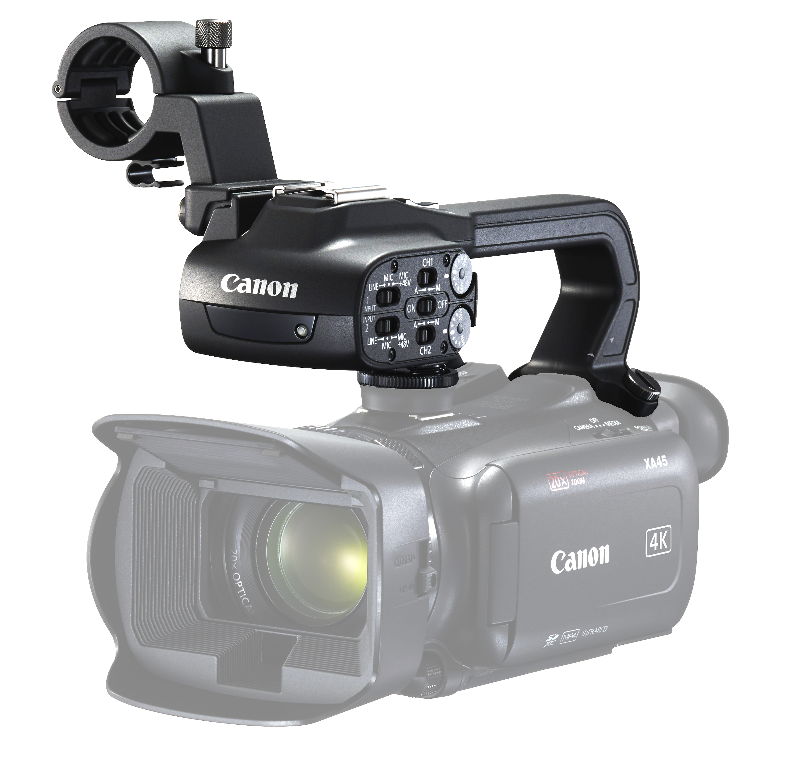

A detachable handle provides the user with expanded audio performance and added flexibility. Removing the handle allows the camcorder to be made more compact for convenient storage when travelling. Included on the handle are the following terminals, controls and monitors:
- Two built-in XLR audio input terminals with phantom power
- Accessory shoe (cold)
- External microphone holder
- Manual audio level control
- Zoom control and record start/stop button
- Infrared light
- Tally lamp

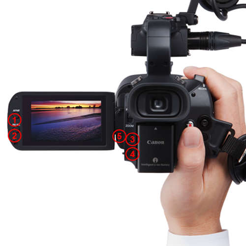

The XA45 Professional Camcorder is equipped with five assignable buttons so that the camcorder can be tailored to the specific preferences or needs of the user.
Button 1 is preset as AF/MF.
Button 2 is preset as Pre REC.
Button 3 has no preset.
Button 4 has no preset.
Button 5 is preset as Rec Review.

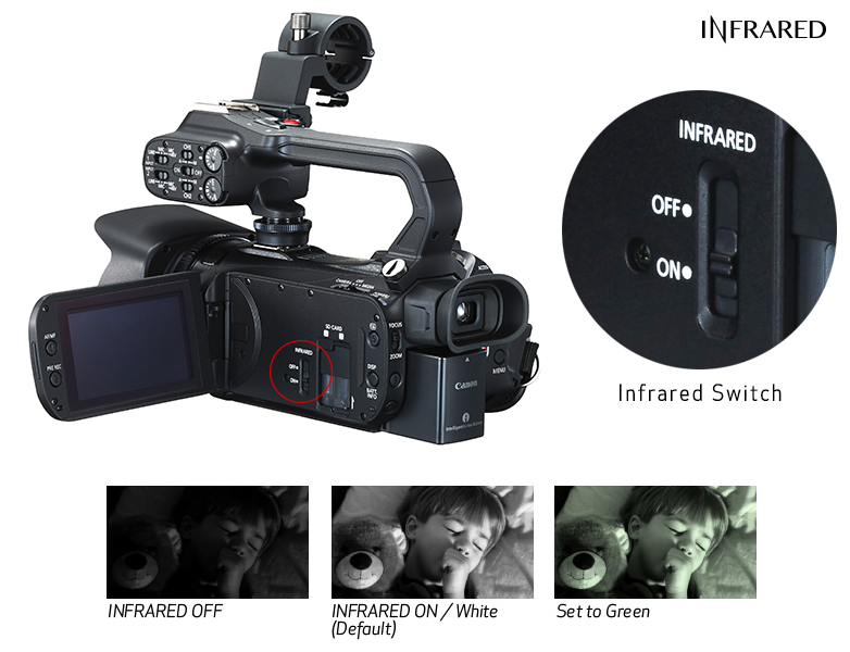

The XA45 Professional Camcorder features an Infrared Mode allowing the capture of video in conditions with little to no ambient light. Compared to the XA25 and XA20, the XA45 can shoot at brightness levels that are approximately 1.4 times more sensitive, and allows low-light capture by removing the infrared cutoff filter from the optical path. Its specially designed lens coating allows the infrared light to pass through to the image sensor.
Additionally, the detachable handle of the XA45 features an infrared emitter with a diffuser to shoot appealing infrared imagery even in complete darkness. For evening camera crews or nature documentary makers, the benefits of a compact, high-performance camcorder for shooting in such conditions are obvious. Without the need to add lights, the shooter can save time on set-up, or blend into the background to reduce their chance of being seen by the subject. Also, the XA45 gives the option of recording in white or green mode.

| Frame Rate | 4K UHD: 30p, 24p FHD: 60p, 30p, 24p |
