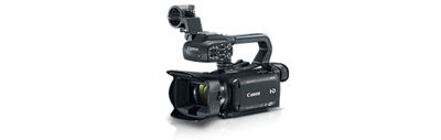

For fast, compact, and powerful performance specially suited for on-the-go Electronic News Gathering (ENG) production, corporate videos and higher education, Canon’s XA35 Professional Camcorder offers a remarkable combination of portability, image quality and I/O capability. Its HD/SD-SDI Terminal offers easy connectivity to broadcast vans, workstations and other digital cinema/TV hardware, helping to provide incredibly fast transfer of uncompressed video with timecode and audio embedded for rapid productions. Plus, with a Genuine Canon 20x High Definition Optical Zoom lens and a newly designed HD CMOS Pro Image Sensor with improved low-light performance, the XA35 captures superb Full HD 1920x1080 video. It features two new modes: Wide DR Gamma and Highlight Priority, which help to deliver an expansive range of colors and tones virtually consistent with how they’re seen by the naked eye. A new interval recording option rounds out the XA35’s ability to capture dramatic footage on the fly with fast motion of up to 1200x the original speed. All this makes for a camcorder that helps facilitate speedy, outstanding-quality video capture that can be ideal for broadcast news, sports events, documentaries and other fast-moving recording situations.

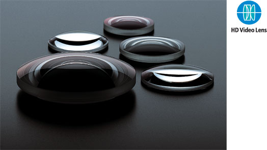

The XA35 Professional Camcorder features a Genuine Canon 20x HD Zoom Lens that provides a highly versatile zoom range with 35mm equivalent of 26.8576mm, and a minimum object distance of just 23.6 inches (60cm) to help capture newsworthy recordings near and far. The impressive image quality is enhanced by an 8-blade Circular Aperture design, which helps to avoid the “starburst” effect of point light sources in non-circular aperture designs. Out-of-focus areas are smooth, natural and appealing. An endless-type focus and zoom control includes user-programmable direction and sensitivity modes. Zoom speed can be set to either a variable or constant (with 16 levels) speed setting, with Fast, Normal, or Slow zoom speed levels.
New, Advanced HD CMOS Pro Image Sensor
For incredibly sharp and detailed high-definition video recording, the XA35 Professional Camcorder features a reengineered, 1/2.84-inch, 2.91 Megapixel HD CMOS Pro Image Sensor that captures approximately 2136x1362 pixels. Thanks to the sensor's enhanced sensitivity, the XA35 helps provide vivid, accurate recording through an improved signal-to-noise ratio.

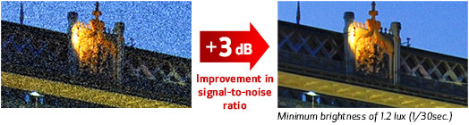

Featuring an improved, low-luminance noise rating of +3 dB, the XA35 Professional Camcorder is able to capture clearer, sharper images in lower light, with even better detail.
Multiple recording modes, resolutions and frame rates make the XA35 Professional Camcorder creatively flexible and adaptable to virtually any news-gathering environment. It can record in Full HD resolution in both AVCHD and MP4 recording codecs, at multiple bit rates, and even simultaneously.

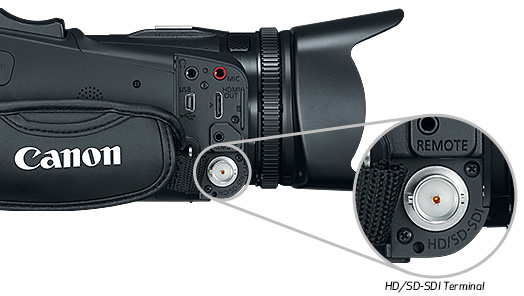

The XA35 Professional Camcorder amplifies convenience with an HD/SD-SDI terminal, whether streaming directly to a broadcast van or connecting to a recorder to make high-quality video recordings for archiving purposes. Designed for professional broadcast use, HD/SD-SDI output provides an uncompressed signal at 1920x1080 resolution with 4:2:2 color sampling and embedded audio and time code.
HD-SDI
Video Standard: SMPTE 292M (1080i/720p)
Embedded Audio Standard: SMPTE 299M
Time Code Standard: SMPTE 12M
SD-SDI
Video Standard: SMPTE 259M (480i)
Embedded Audio Standard: SMPTE 272M

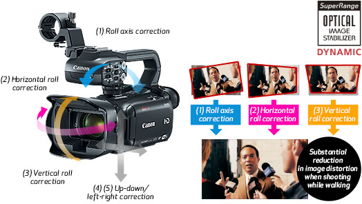

The XA35 Professional Camcorder offers a powerful optical image stabilization system suited to help reduce image blur in a wide variety of shooting situations. The different image stabilization options can be selected manually, or Intelligent IS can use an automatic detection system to identify the proper stabilization mode for the situation. Featured on the XA35 is Dynamic Mode, which provides electronic correction of roll and tilt.
Used for image stabilization at the wide end, Dynamic IS builds on translational (up-down/left-right) stabilization, adding roll axis correction, horizontal roll correction and vertical roll correction for five-axis correction. Image distortion is substantially reduced, even when shooting while in motion.
Macro IS
Macro IS corrects angular and shift-type shake in wide-angle shots.
Powered IS*
Used for image stabilization in telephoto shooting, Powered IS corrects for low-frequency camcorder shake.

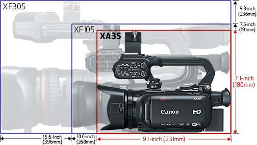

Weighing less than three pounds including the detachable handle, battery and lens hood and less than two pounds without the XA35 Professional Camcorder is ideal for high-action shoots when both speed and mobility are essential, and where keeping a low profile is an added benefit. Though small in size, this camcorder sacrifices nothing when it comes to professional functionality. It features a “seesaw” style zoom lever, manual focus/zoom ring and joystick for easy control and an electronic viewfinder that can tilt up to 45° for low-angle shooting. It also has five Assign Buttons to help it fit to your operational needs.

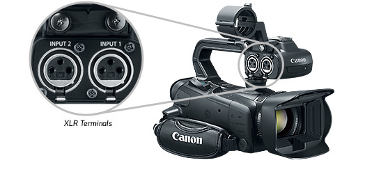

A stereo microphone is incorporated into the XA35 Professional Camcorder, as are two XLR audio inputs with +48 V phantom power. The built-in microphone provides outstanding audio in fast-paced situations while the XLR inputs provide connectivity to external microphones and other professional audio devices. If you choose, the built-in microphone and XLR input can be used simultaneously.
Audio is recorded in 16-bit PCM format at 48 kHz for amazing quality and fidelity. And both the built-in microphone and XLR inputs have the option for automatic or full manual gain control. To prevent variations in the recorded audio level, the dial can also be locked.
The XA35 also includes a 3.5mm headphone terminal with 16 volume settings for accurate audio monitoring.

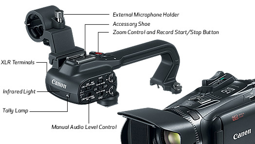

A detachable handle provides the user with expanded audio performance and added flexibility. Removing the handle allows the camcorder to be made more compact for convenient storage when travelling. Included on the handle are the following terminals, controls and monitors:
• Two built-in XLR audio input terminals with phantom power
• Accessory shoe (cold)
• External microphone holder
• Manual audio level control
• Zoom control and record start/stop button
• Infrared light
• Tally lamp

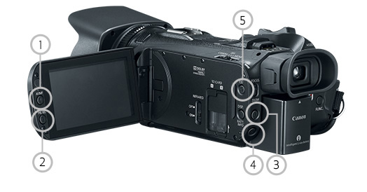

The XA35 Professional Camcorder is equipped with five assignable buttons so that the camcorder can be tailored to the specific preferences or needs of the user.
Button 1 is preset as AF/MF.
Button 2 is preset as Pre REC.
Button 3 has no preset.
Button 4 has no preset.
Button 5 is preset as Rec Review.

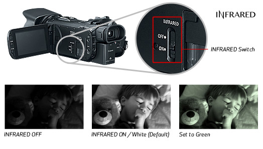

The XA35 Professional Camcorder features an Infrared Mode allowing the capture of video in conditions with little to no ambient light. Improved from the XA25 and XA20, it can shoot at brightness levels that are approximately 1.4 times more sensitive, and allows low-light capture by removing the infrared cutoff filter from the optical path. Its specially designed lens coating allows the infrared light to pass through to the image sensor. Additionally, the detachable handle of the XA35 features an infrared emitter with a diffuser to shoot appealing infrared imagery even in complete darkness. For evening camera crews or nature documentary makers, the benefits of a compact, high performance camcorder for shooting in such conditions are obvious. Without the need to add lights, the shooter can save time on set-up, or blend into the background to reduce their chance of being seen by the subject. Also, the XA35 gives the option of recording in white or green mode.
