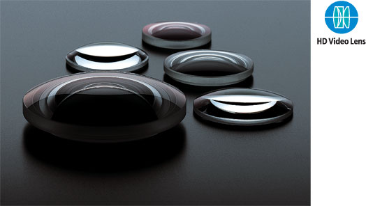

The XA20 features a Genuine Canon 20x HD Zoom Lens that provides a highly versatile zoom range with 35mm equivalent of 26.8mm576mm, and a minimum object distance of just 23.6 inches (60cm). The impressive image quality is enhanced by a new 8-Blade Circular Aperture design, which avoids the “starburst” effect of point light sources in non-circular aperture designs. Out of focus areas are smoother, more natural and more appealing. An endless-type focus and zoom control includes user-programmable direction and sensitivity modes. Zoom speed can be set to variable, constant (with 16 levels), Fast, Normal or Slow.

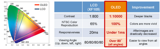

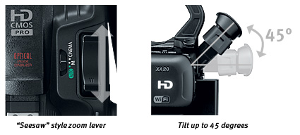

The new 3.5-inch, advanced 1,230,000-dot equivalent Organic Light-Emitting Diode (OLED) display provides vivid colors, high contrast, and dramatically improved responsiveness compared to traditional LCD screens. A wide-view angle (over 80 degrees at all angles) aids in composition versatility, and regular chromaticity adjustments, prompted by the camcorder, ensure correct brightness and faithful color reproduction.
EVF
The 0.24-inch tilt-type color electronic viewfinder on the XA20 has approximately 100% field of view, and 1,560,000 dots of resolution help ensure critical focus adjustment, with peaking applied if necessary. A joystick located to the right of the viewfinder, where the thumb rests, enables control of camera settings on the viewscreen without having to use touch panel controls.

Power Zoom
Power zoom is available in Constant and Variable settings in 3 modes: Fast (approx. 1.960 seconds), Normal (approx. 2.5180 seconds) and Slow (approx. 4.0285 seconds). To provide added control, there are 16 predefined steps in Constant mode.

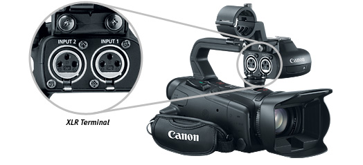

A stereo microphone is incorporated into the XA20 Professional Camcorder, as are two XLR audio inputs with +48V phantom power. The built-in microphone provides exceptional audio in fast-paced situations while the XLR inputs provide connectivity to external microphones and other professional audio devices. If you choose, the built-in microphone and XLR input can be used simultaneously.

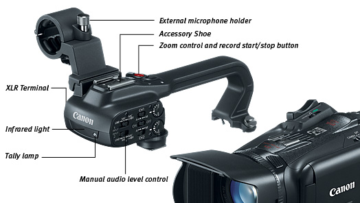

A detachable handle provides the pro shooter with expanded audio performance and added flexibility. Removing the handle allows the camcorder to be made more compact for convenient storage when travelling. Included on the handle are the following terminals, controls and monitors:
- Two built-in XLR audio input terminals with phantom power
- Accessory shoe (cold)
- External microphone holder
- Manual audio level control
- Zoom control and record start/stop button
- Infrared light
- Tally lamp

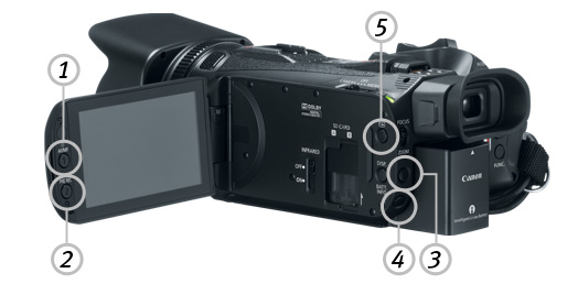

The XA20 is endowed with five assignable buttons so that the camcorder can be tailored to the specific preferences or needs of the user.
Button 1 is preset as AF/MF; it can be set to: Powered IS, BLC Always On, Face Only AF or Video Snapshot.
Button 2 is preset as Pre REC; it can be set to: WB Priority, IR Light, Audio Output CH, AF/MF or Rec.
Button 3 is preset as Rec Review; it can be set to: Review, Shooting Mode, BLC Always On, White Balance or AGC.
Button 4 has no preset; it can be set to: Limit, Focus, Exposure, Audio Scene, Microphone Level or Zoom.
Button 5 has no preset; it can be set to: Image Stabilizer, Image Effects or Wi-Fi® Remote.

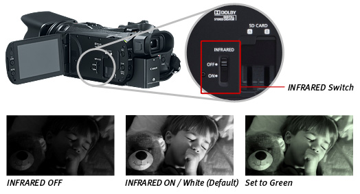

The XA20 Professional Camcorder features an Infrared Mode allowing the capture of video in conditions with little to no ambient light. It does so by removing the infrared cutoff filter from the optical path. Its specially designed lens coating allows the infrared light to pass through to the image sensor. Plus, the power of the infrared light is enhanced by 2.7 times compared to that of the XA10 camcorder. Additionally, the detachable handle of the XA20 features an infrared emitter with a diffuser to shoot pleasing infrared imagery even in complete darkness. For nature videographers or law enforcement users, the benefits of a compact, high performance camcorder for shooting in such conditions are obvious. Without the need to add lights, the shooter may remain hidden from subjects. Also, the XA20 gives the option of recording in green or white light mode.
