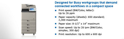

| Model Name | ImageRUNNER ADVANCE C250iF |
| Type | Color Digital Multifunction Imaging System |
| Functions | Copy, Print (UFR II, PCL 5c/6, Adobe® PostScript® 3™), Fax (Up To 1 Line), Scan, Send |
| Operation Panel | 7" WVGA Full-Color TFT Screen |
| Image Server Memory | Standard: 2 GB RAM Maximum: 2 GB RAM |
| Hard Disk Drive | Standard: 80 GB Maximum: 80 GB |
| Network Interface Connection | Ethernet 10/100/1000Base-TX |
| Other Interface | USB 2.0 X3 (Host), USB 2.0 (Device) |
| Advanced Box Features | Store To Remote Advanced Box: Supported Print/View From Remote Advanced Box: Supported |
| Standard | Store To USB Memory |
| Network Twain Scan | Standard: Network WIA Scan |
| Network Scan Utility | Color Network ScanGear 2 |
| Letter | Up To 26/26 Ppm |
| Legal | Up To 21/21 Ppm |
| First Copy Time | As Fast As 8.4 Seconds (BW) And 10.5 Seconds (Color) |
| Multiple Copies | 1 To 999 |
| Copy Exposure | Automatic Or Manual (9 Levels) |
| Magnification | 25 - 400% (1% Increments) |
| Preset Reductions | 25%, 50%, 64%, 78% |
| Preset Enlargements | 129%, 200%, 400% |
| Standard Paper Capacity | (20 Lb. Bond): 550-Sheet Paper Cassette 100-Sheet Stack Bypass |
| Optional | 1 X 550-Sheet Paper Cassette 3 X 550-Sheet Paper Cassette |
| Maximum Paper Capacity | 2,300 Sheets |
