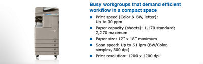

| Model Name | ImageRUNNER ADVANCE C2230 |
| Type | Color Digital Multifunction Imaging System Letter: Up To 30/30 Ppm Legal/11" X 17": Up To 15 Ppm |
| Functions | Standard: Copy, Print (UFR II), Scan, Send Optional: Print (PCL, Adobe® PostScript® 3), Fax (Up To 2 Lines) |
| Operation Panel | 7" WVGA Full-Color TFT Screen |
| Image Server Memory | Standard: 2GB RAM Maximum: 2GB RAM |
| Hard Disk Drive | Standard: 80GB Maximum: 80GB |
| Network Interface Connection | Standard: 1000Base-T/100Base-TX/10Base-T |
| Other Interface | Standard: USB 2.0 (Host) X 2, USB 2.0 (Device) Optional: Device Port [USB 2.0 (Host) X 2], Copy Control Interface |
| Standard | USB Memory |
| Optional | SD, SDHC, CompactFlash, Memory Stick, Microdrive |
| Network Twain Scan | Standard |
| Network Scan Utility | Color Network ScanGear |
| Multiple Copies | 1 To 999 |
| Copy Exposure | Automatic Or Manual (9 Levels) |
| Magnification | Magnification: 25% - 400% (1% Increments) From Platen Glass Magnification: 25% - 200% (1% Increments) From Document Feeder |
| Preset Reductions | 25%, 50%, 64%, 73%, 78% |
| Preset Enlargements | 121%, 129%, 200%, 400% |
| Standard Paper Capacity | One 550 Sheet Paper Cassette 100-Sheet Stack Bypass |
| Optional | Dual 550 Sheet Paper Cassettes |
| Maximum Paper Capacity | 2,270 Sheets |
| Output Paper Capacity | (20 Lb. Bond): Standard: 250 Sheets (Inner Tray) Maximum: 3,000 Sheets (W/Staple Finisher Or Booklet Finisher) |
| Cassette | Cassette 1: 11" X 17", Letter, Executive Cassettes 2/3/4: 12" X 18",* 11" X 17", Legal, Letter, Letter-R, Statement-R, Executive, Custom Size (5-1/2" X 7-1/8" To 12" X 18") |
| Bypass | 12" X 18", 12-5/8" X 17-11/16", 11" X 17", Legal, Letter, Letter-R, Statement, Statement-R, Executive, Custom Size (3-7/8" X 5-1/2" To 12-5/8" X 18") |
| Other Option | Envelope Feeder Attachment (COM10 No.10, Monarch, DL, ISO-C5)** Tab Feeding Attachment Kit** |
| Cassette | Cassette 1: 17lb. Bond To 32 Lb. Bond (64 To 120g/M2) Cassettes 2/3/4: 17 Lb. Bond To 60 Lb. Cover (64 To 163g/M2) |
| Bypass | 17 Lb. Bond To 80 Lb. Cover (64 To 220g/M2) |
| Paper Size | Standard Automatic Trayless Duplexing (Executive To 12" X 18") |
| Paper Weight | 17lb. Bond To 32 Lb. Bond (64 To 120g/M2) |
| Warm Up Time | From Power On: 34 Seconds, From Sleep: 10 Seconds, Quick Startup Mode: 7 Seconds*** |
| Power Requirements | 120V AC, 60Hz, 7.5A |
| Power Consumption | Maximum: 1.5kW Sleep Mode: 0.8W |
| Plug | NEMA 5-15P |
| Dim | 36-1/2" X 22-1/4" X 26-3/4" (928mm X 565mm X 680mm) |
| Installation Space | 33-3/8" X 28-3/4" (846mm X 680mm) (When The Multi-Purpose Tray Is Extended.) |
| Weight | Approx. 198 Lb. (90kg)† |
| Scan Resolution | Up To 600 X 600 Dpi |
| Acceptable Originals | (Glass): Sheet, Book, 3-Dimensional Objects [Up To 4.4 Lb. (2kg)] |
| Maximum Original Size | Up To 11" X 17" |
| Basic Copy Features | First Copy Time: BW: 5.9 Seconds, Color: 8.9 Seconds |
