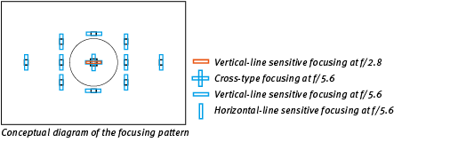

The EOS 6D has an entirely new 11-point AF system for fast, accurate AF no matter the situation. With its new centered cross-type AF point with EV -3 sensitivity for improved performance and focus in low light, and a newly developed and bright 21mm eye point viewfinder with 97% coverage, the EOS 6D offers impressive performance in both composition and AF, even in the dimmest lighting situations. Offering not only One-Shot AF, AI Servo AF, and AI Focus AF, the EOS 6D’s AI Servo focus can be customized with tracking, acceleration and deceleration tracking sensitivities, and 1st or 2nd image priority adjustments. For even more customization, adjustment levels for the wide-angle and telephoto ends of particular lenses can be entered and recorded into the camera’s memory.

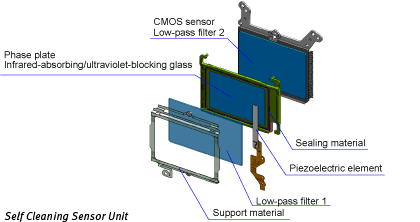

EOS Integrated Cleaning System for improved vibration-based dust removal
The Integrated Cleaning System featured in the EOS 6D delivers great dust removal for clearer images. To prevent dust accumulation, the system removes particles on the surface of the glass filter by vibrating the glass ultrasonically. The particles are then absorbed by an adsorbent at the bottom of the unit; the unit itself is completely sealed for protection against external contaminants, and the front face of the low-pass glass filter is treated with an anti-dust fluorine coating, making it easier to remove damp or sticky dust particles.

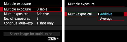

Multiple Exposure Control
The EOS 6D offers a Multiple Exposure mode for film-like image creation with the convenience of in-camera processing. It offers two different compositing methods for proper exposure and composition: additive or average. Multiple exposure shots from 2 to 9 are stored as one final image and can be taken in both RAW and JPEG shooting modes. A RAW image previously captured by the EOS 6D (3:2 aspect ratio only) can be used as a starting point, and cumulative results can be observed and corrected in real time on the camera's LCD screen.

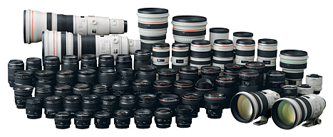

| Compatible Lenses | Canon EF Lenses (Except EF-S And EF-M Lenses) |
| Lens Mount | Canon EF Mount |

| Low Pass Filter | Fixed Position In Front Of The CMOS Sensor |
| Dust Deletion Feature | (1) Self Cleaning Sensor Unit

| Type | TTL Secondary Image-Forming Phase-Difference Detection System With AF-Dedicated CMOS Sensor |
| Af Points | 11 Points Center: Cross-Type At F/5.6; Vertical Line-Sensitive At F/2.8. Upper And Lower AF Points: Vertical Line-Sensitive AF At F/5.6. Other AF Points: Horizontal Line-Sensitive AF At F/5.6. |
| Af Working Range | Center AF Point: EV -3 To 18 (At 73°F/23&DegC, ISO 100) Other AF Points: EV +0.5 To 18 (At 73&DegF/23&DegC, ISO 100) |
