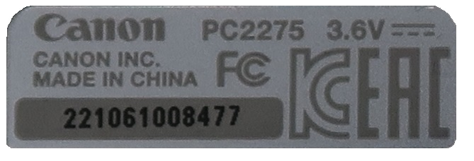

The phenomenon may occur in cameras whose first two digits in its serial number are “11”, “12”, “21”, “22”, ”23” or ”24”.
(Examples of serial numbers for cameras that may be affected: “11xxxxxxxxxx”, “12xxxxxxxxx”, “21xxxxxxxxxx”, “22xxxxxxxxxx”, “23xxxxxxxxxx” or “24xxxxxxxxxxx” (‘x’ can be any number)).

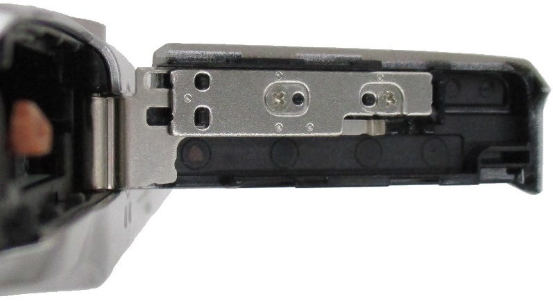

If the camera has a black marking on the inside of the battery cover, as shown in the image below, this indicates that your camera has been checked and the issue has been corrected.
